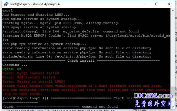

安装LNMP稳定版
wget -c http://soft.vpser.net/lnmp/lnmp1.4.tar.gz && tar zxf lnmp1.4.tar.gz && cd lnmp1.4 && ./install.sh 两次均失败,见下图。
============================Install PHPMyAdmin=================================
============================phpMyAdmin install completed=======================
The service command supports only basic LSB actions (start, stop, restart, try-restart, reload, force-reload,
status). For other actions, please try to use systemctl.
Add Startup and Starting LNMP...
Add nginx service at system startup...
Starting nginx... nginx (pid 3908 3905) already running.
Add mysql service at system startup...
/etc/init.d/mysql: line 244: my_print_defaults: command not found
Starting MySQL ERROR! Couldn't find MySQL server (/usr/local/mysql/bin/mysqld_safe)
Add php-fpm service at system startup...
error reading information on service php-fpm: No such file or directory
include/end.sh: line 54: /etc/init.d/php-fpm: No such file or directory
============================== Check install ==============================
Checking ...
Nginx: OK
Error: MySQL install failed.
Error: PHP install failed.
Sorry, Failed to install LNMP!
Please visit https://bbs.vpser.net/forum-25-1.html feedback errors and logs.
You can download /root/lnmp-install.log from your server,and upload lnmp-install.log to LNMP Forum.
[root@lpcb lnmp1.4]# ‘’
我的HOST VPS主机配置
Operating System
CentOS 7.1 x86_64
Disk Space
10 GB
Bandwidth
512 GB
Memory
256 MB
图片附件: shib1.JPG (2017-6-24 11:08, 40.85 KB) / 下载次数 1278

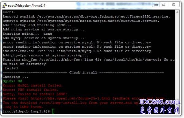

作者: zhutingqi    时间: 2017-6-24 12:31
LNMP里面全部选择低版本也一样出错。
图片附件: 0624.jpg (2017-6-24 12:31, 40.37 KB) / 下载次数 1287
http://idc866.com/attachment.php?aid=3100&k=d7f08d1f23605503f4111830df0d8704&t=1790794718&sid=AZfX3j
作者: idc886    时间: 2017-6-30 06:25
内存不足吧。
选择的数据库版本过高吧。
不然256M是足够可装的。
作者: zhutingqi    时间: 2017-6-30 10:55
应该是机器问题,换512的装任意系统都可以了。
